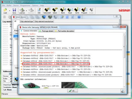

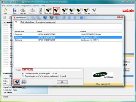

Open the control program, click "Select" and enter the part number of the device you would like to program into the "Search" box. When you have found the device you would like to program, click on it once so it is highlighted. Click the "Device info" button and a new window will open displaying further details about the device. The "Common information" tab shows the programmers which support the device and which adapter is required. If the device is to be programmed through the ISP connector, then no adapter is required.
