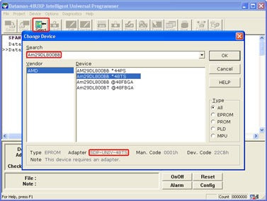

All the information required to select the correct general purpose adapter, device specific adapter or flash adapter can be found in the control program for the programmer. This can be done without the programmer connected.
Open the control program, click "Select" and enter the part number of the device you would like to program into the "Search" box. When you have found the device you would like to program, click on it once so it is highlighted. The section below the device part number shows further details about the device and which adapter is required. If no adapter is shown, then no adapter is required.
In the case that no adapter is listed or it is not clear which adapter is required or if you would simply like confirmation of the correct adapter then please submit a Technical Support Request and our support team will respond within 24h.
