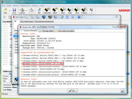

All the information required to select the correct general purpose adapter, device specific adapter or module can be found in the control program for the programmer. This can be done without the programmer connected but make sure to select "DEMO" when prompted.
Open the control program, click "Select" and enter the part number of the device you would like to program into the "Search" box. When you have found the device you would like to program, click on it once so it is highlighted. Click the "Device info" button and a new window will open displaying further details about the device. The "Common information" tab shows the programmers which support the device and which adapter is required. If no adapter is shown or the device is to be programmed through the ISP connector, then no adapter is required.
